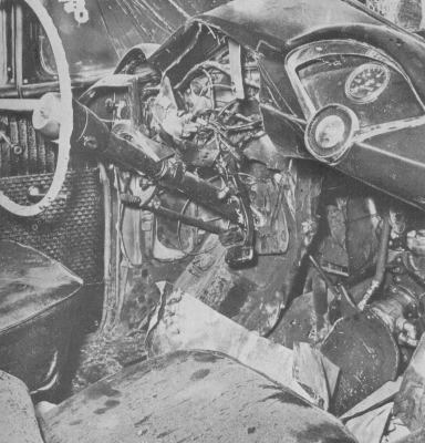

Absolutely correct, An SFI bellhousing that is out of certification can be had relatively cheap. I think it will handle the power of the stock 400 going in the car for now. It has slightly less horsepower than the blown nitro burning HEMI's the front engined dragsters ran. ;)
If you've ever seen the aftermath of a clutch explosion, you would never even consider anything but a blowproof bellhousing in a hot street car.
Rocket
Jul 1, 2010
288
Holy $#!@ I have a 513 aluminum bell now.... when I drop my stroker in I am definitely going with a blow proof . Yikes.
