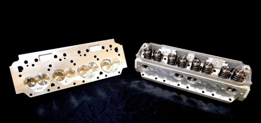

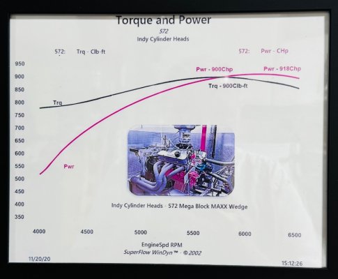

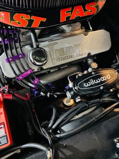

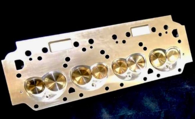

Indy Cylinder Heads built my engine which include Indy aluminum heads. It’s a 572 with 918 hp and 900 lbs torque and never goes beyond 220 degrees in hot summers with AC blasting. Those Indy heads are the best I’ve ever used… and I’ve tried them all. Not saying others are not good… a lot are good, just not quite as good as the Indy. There’s a reason a lot of pro drag racers go the Indy route!

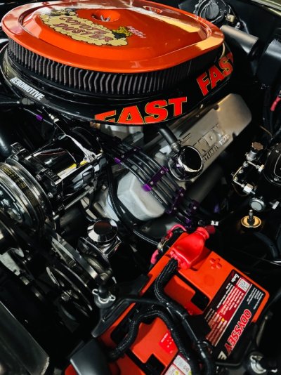

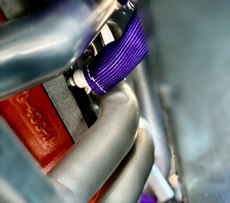

Here's a picture of my Stroker when I had just installing the fuel injection unit

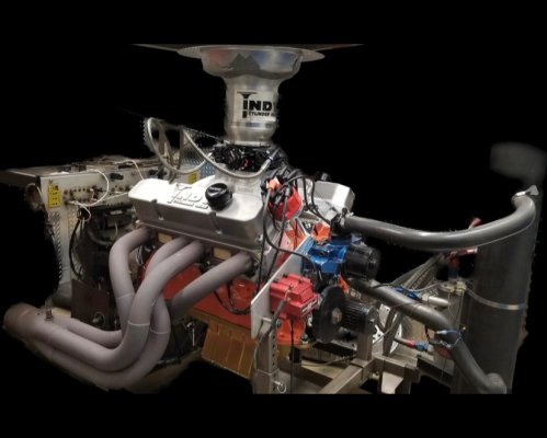

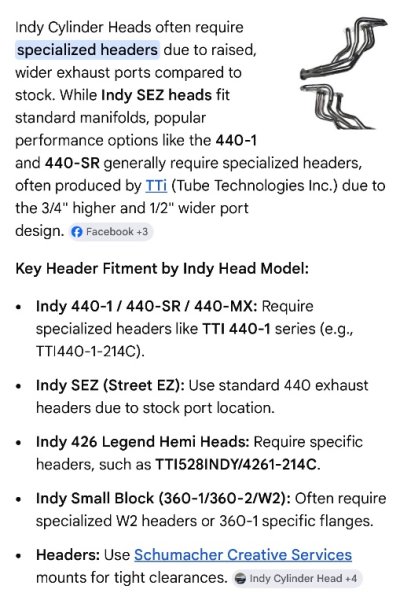

One important thing that I did forget to mention was when using the Indy aluminum heads you also have to go with the TTI Headers due to the angle of the exhaust ports. The Indy head configuration with the TTI headers really push the exhaust out much faster than the other (well known) heads. The dyno results were significantly improved after switching from 440
Source and Edlebrock with Hookers to the Indy with TTI’s
