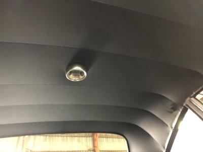

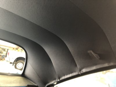

Russ don’t leave a bunch of wrinkles in your headliner there ain’t enough sun in Florida to take a trapped wrinkle out. Just saying. Take your time and don’t get in a hurry and you’ll be fine . You can slide the bows in and hang it and leave it for a day helps relax the material .
7,713
3,252
I have a heat gun my wife won't let me use the hair dryer any more. LOL. They say it is a good tool to remove the wrinkles out once it is in the car. The car won't get out side of the paint booth jail till it is done. Thanks for the info.
