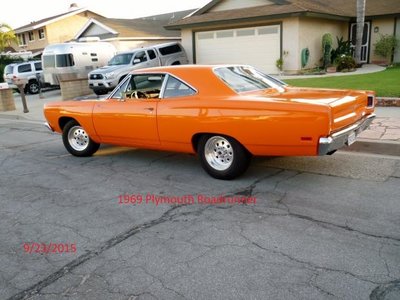

Has anyone converted their 69 RR from a manual 4 speed to a Torqueflite 727 automatic transmission.
If so, what are the things to watch out for??
I have newly rebuilt 4 speed manual with a new clutch that I will be replacing with a 727 tranny.
What are the best years for the transmission??
Any advise would be greatly appreciated.
LG,
Mike
