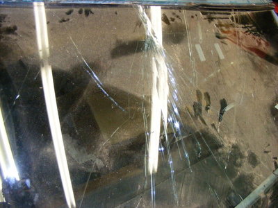

I never have a problem taking glass out.... well almost never
