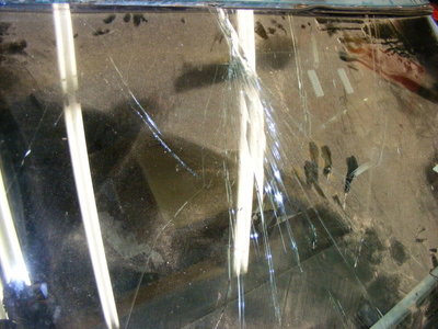

I remember when I was parting out '68'-'70 Chargers. To get the back glass out, I used to lay on the back seat, and just push the glass out with my feet after running a utility knife around the glass. never broke one either. sure wouldn't try that now.
I never have a problem taking glass out.... well almost never
