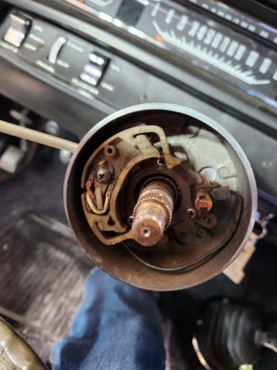

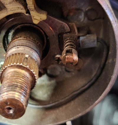

I have a 1969 Plymouth Road Runner. I have previously posted here about my problem making the Beep-Beep horn work on my car. Thanks to input from members that problem was solved. However, I recently removed the steering wheel and replaced it with a new one. Now the horn will not work again. I replaced all of the horn button contact points parts with new aftermarket units. They were worn and I thought replacing would eliminate future problems. I noticed as I was replacing the parts that the spring loaded brass roller contact was not round but looked lumpy. The spring itself works just fine. I could not find anywhere that had a replacement for this part. So I carefully put everything back together replacing all of the old horn button parts except for this brass roller (Picture of roller included). Horn would not work at all. I am sure someone has had this problem before. Can anyone give me a vendor that has this part? Or what did you do to make the horn work. Took the car to the Good Guys Nationals last weekend in Scottsdale and someone wanted to hear the Beep-Beep horn. I was very embarrassed to say it does not work. Help please! Thanks.

yes that roller part is bad and it is what transfer the ground for the horn to work thru the relay . you can download the factory service manual to help you. looks like the steering wheel is out of round as it is hitting the upper part of the caller of the steering column.

Located the correct part. It is called a turn signal assembly. Popped right up when entered with several vendors with the part available. Thanks for the help.
