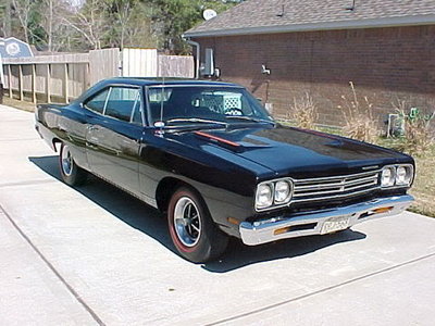

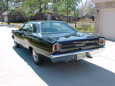

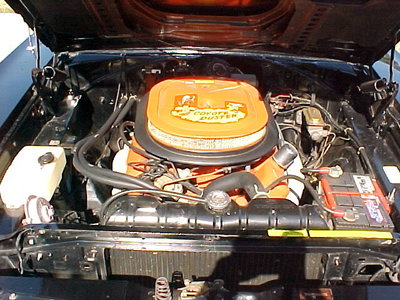

Tom please forgive my memory(I just finished my 7 days of midnight) but I don't remember that black beauty of yours. Please, post more pics with all the details! :drool:
tom99
Mar 27, 2009
56
18
It's the original 383, A-727 torqueflite, 3.23:1 Sure grip, Air Grabber Hood, Tinted Windows, Styled Road Wheels, and an AM Radio.
I've owned it for just over 20 years.
724
:drool: :drool: :drool: :drool: :drool: :drool: :drool: :drool: :drool: :drool: :drool: :drool:
:cheers: :cheers: :cheers: :cheers: :cheers: :cheers: :cheers: :cheers: :cheers: :beep: :beep: :beep: :beep: :beep: :beep: :beep: :beep: :beep: :beep: :beep: :beep:
Have I mentioned lately that I like BLACK cars. That is AWESOME!!!!!
