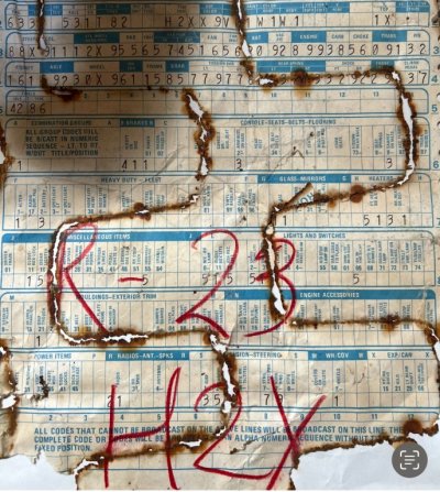

Hey all, here is a pic of my build sheet. I’ve managed to decode most of it. My main question is about the hood. I know that it doesnt have v21 stripe package, but the hood is black and I’m wondering if that is designated by X9 under UDF? It’s V01 monotone paint, but I’m unsure if that’s the whole car or what. It was sold to me as a 1 owner car and so far the only thing that isn’t right is the rallye rims instead of roads

Are you saying the whole hood is painted flat black? I think the only option for `69 is the optional V21 hood treatment.

UDF is Upper Door Frame. The only black hood was fiberglass on the A12 cars unless of coarse the car is black.

Yep! That’s why I’m confused. When I get back out there I’ll get some better pictures and see what else I can come up with. the 383 callouts are there, but no plymouth emblem. So, probably painted. Haha. I’m shooting for as original as possible with this girl. I haven’t hauled it home from my friend’s place yet. There is about a dozen cars in front of her at his place, and a half dozen cars that should be in front of it on my list. So instead of working on one of 3 a body barrcudas that need attention, I am currently obsessing over this one. Haha
