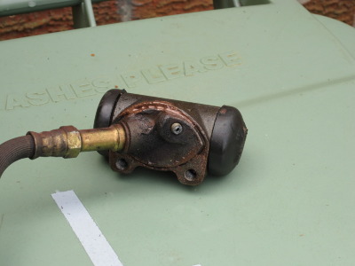

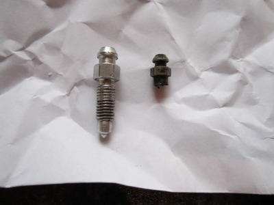

Started work on the brakes today as my new cylinders arrived.I changed both flexi hoses too while I was at it.
One problem I've got though is the bleeder on new cylinder is a bit bigger than the old(see pics).I now can't get a clear plastic tube over the end to bleed as it is so tight to the knuckle,you can just about slide a peice of card between them when the bleeder is open 1/2 a turn.
The cylinder is the exact part number as the one already fitted so it looks like they upgraded to a stronger bleeder.Now I have to go to the local parts store to see if they have a shorter one.What a PITA.

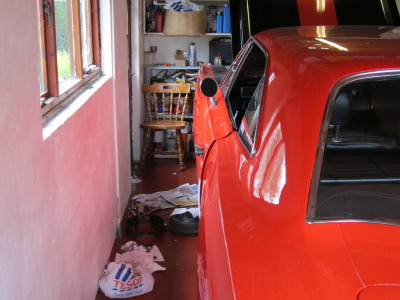

301
damn , your garage looks as tight as your driveway!
Jim S.
Aug 3, 2009
1,798
White Bear Lake, Mn.
I am in a somewhat similar situation but, not quite as bad as you. I commend you for working in such a narrow garage. I know what its like to have to angle the floor jack (without the extension handle) so it does not hit the wall. :worship:

Had no luck tracing a small bleeder so I'm going to swap one from the rear to the front.Why does what should be a simple job sometimes turn into a long one dontknow.gif
