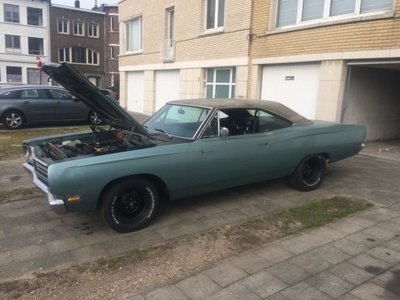

Hi guys, you will rmember me posting some pics of my Runner in the newbie section, some time ago.
Here is how she sits right now:

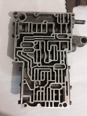

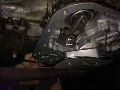

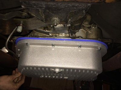

Once the car arrived from the States the front brakes were leaking, transmission was not working and also leaking.
So my buddy and I replaced the front brake and caliper lines and inspected the trans.

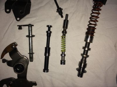

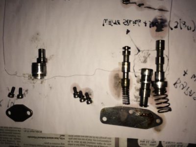

The input shaft seal was leaking so I decided since the valv body had to come out to install a Transgo TF2 shift kit. Together wit a Moroso gasket and deep pan and 10.4L :eek-new: of fresh oil she now becomes driveable again.

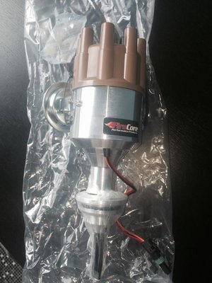

I got a new engine harness and Fire Core distributor kit ready to install. This will be done after the car is inspected and licenced. The motor now runs silky smooth, steers and stops really good (factory disk brakes is nice to have)...

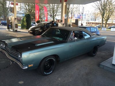

at the gas station

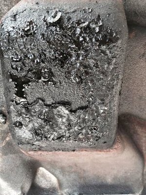

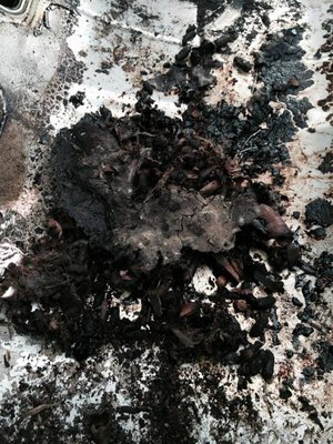

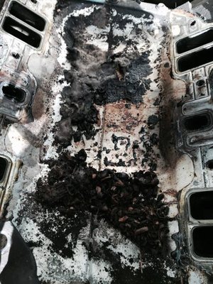

The runner suffers from hard staring when hot, even stalling at the stop light. So I did some research on vapor lock and decided to dig into the fuel delivery system.
I removed the carburator and stock iron intake. Look what I found in my valley pan :eek:
a lot of the junk was backed on the underside of the manifold.
I ordered a new FelPro heat crossover valley pan gasket and a 1/2" spacer to prevent boiling the gas in my Carb.
Once I get them I'll post some pics. Thanks for watching:popcorn:

Well actually, I found half a tree under the manifold. I wonder how that would get there?
I don't know too much about intake mflds to go looking for the stock replacement. I am going to install the 6pack hood eventually so clearance won't be a problem. Or does it?
mice find a way to get all kinds of crap in the tightest spaces. you should have all kinds of clearance with 6 Pak hood.

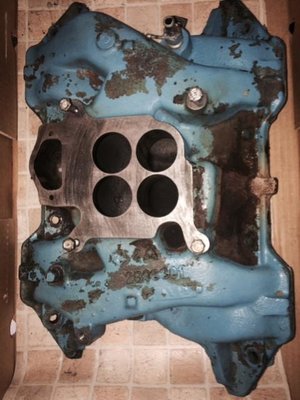

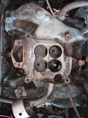

got the manifold back, has been power washed with solvent, it's now nice and clean. Gonna sand it down and paint it back to Mopar Turqoise. Tomorrow the UPS-dude will deliver my gasket and spacer.
before/after
