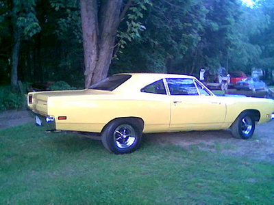

my car the got burned up had a 440 I rebuilt in '86. built it stock, and I had 3.55s. It was a blast to drive. Not a tire shreader, but a great dependable fast car. My yellow car has the original 383, and 3.23s.definatly not as snappy as the 440, but still a blast to drive. But, I took the car out the other day after driving my /6 truck for a couple weeks, and still managed to scare myself. can't wait till spring after it's sat all winter.
