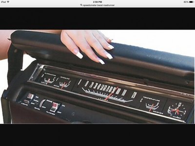

How do I remove this to replace.... There are 2 screws in the finish panel where wiper switch is and 2 screws under top of instrument panel- I've removed them and did not seem to loosen anything
Does the lower dash pad have to come out?

removing dash pad is extreme pain. there are a number of small speednut type fasteners holding pad in and real pain to get to. lower switch panel should come out without removing dash pad. I think dash pad does have to be removed to remove instrument cluster. one hint is to remove pieces and drop or remove steering column. there are only three bolts holding it to the dash and four to the firewall. pop the wiring connector and the roll pin on the coupler and out it pops. gives you much more room under that dash to reach some of those speednuts. a flexible extension for a drill helps a lot also.
the trim you want to take out is attached to the cluster, and the lower pad has to come off to get the cluster off.
