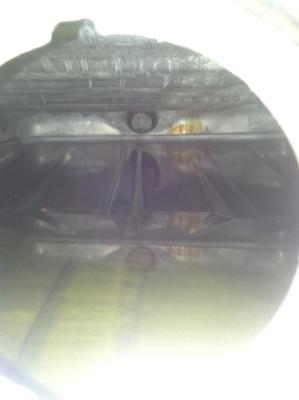

The inside of my original 1970 Chrysler tank.
