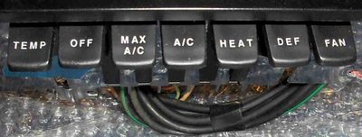

OK, so I have t had my roadrunner long and couldn't locate a similar post for this question. My climate controls do not function properly. IE, they do not all push in like they should. This is a non-A/C car. The current climate controls have controls for A/C (first pic). Am I correct in thinking the controls should be the simpler one to just turn the heat off and on and to defrost (second pic)? Thanks

Absolutely the non A/C controls are all cable and lever functioning controls and the A/C controls are vacuum and the (IIRC) outboard controls are lever cable. I think there is no way to use the heater/defroster/temp control on an A/C equipped car or vice versa.

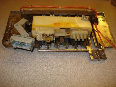

The back view of the A/C heater/A/C control showing the vacuum connections and cable/lever outboard controls
I don't know if I can locate an image of the non-A/C control quickly, maybe some other member can quicker?
