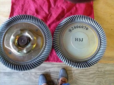

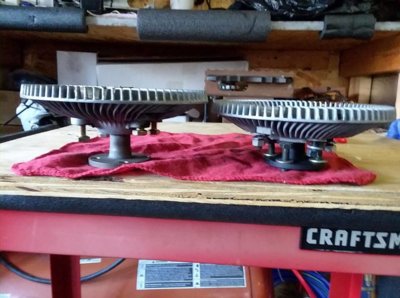

I have two fan clutches one is a AC and the other 070 NON AC. As you can see the AC has a longer shaft and would put the fan in to the shroud where it should be. The 070 putts the fan slightly into the shroud. The is a non ac car and do not care if one is right or wrong. as long as it works for the best cooling !!. the 070 fan clutch is the real deal and Not A Repop !! Has been restored and might be up for sale. Is there any reason that the AC Clutch Fan Drive would not work on a Non Ac Car ?
Thanks Tom C.29339499_1603316456400789_1693593268925208768_n.jpg 29258589_1603316603067441_1260630944618800729_n.jpg
The fan ideally should be a third of the way into the shroud. That 070 clutch is worth its weight in gold and I just used a repop in my 383 project

I have a 1969 hp 440 in my 69 RR .Way doesn't 070 put the fan where it should be ? I ran the 070 fan last summer with no issues but have notice other cars with the fan into the shroud more. And just notice the other day the difference in shaft lenth

BTW, don't store the fan clutches in the positions shown in the pictures in the first post. The silicone fluid will eventually drain past the seals and ruin the clutch.
