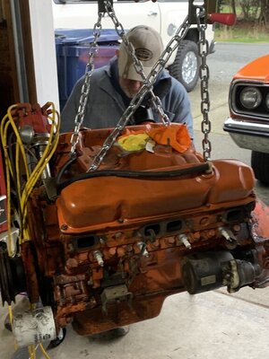

Ok need some help here. I have a 70 RR/ 383? and a A833 18 spline and a 11in. clutch. To the best of my knowledge this setup is for a 440 or 426. The reason for the question is I am having a hard time finding a reasonable priced clutch kit. The info i have found is that a 383 came with a 23 spline transmission. So now I am a bit confused.
P.S I was told the car had another 383 installed at some point and am now questioning whether its a 383? The motor is off for refresh so I don't have the number off the block.

Looks to be a 383 , and I agree with quikbird, don't go cheap, I fixing to replace mine too, bought a diaphragm style this go around, hope I dont regret it, I've always ran borg&beck style

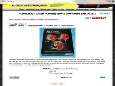

I recently put a McLeod’s kit from Brewers on my Hemi car. 18 spline, 11” clutch. The kit covered everything including a throw out bearing and bushing.

If you know it is 11" and 18 spline that is all the info you need and the diaphragm style will give you a softer pedal. Don't get the 69 hemi set up it is 10.95 inch with a different bolt pattern

The simple answer is to count the number of teeth on the flywheel. That will tell you what clutch the system is supposed to have. The 130 tooth is most commonly found with the aluminum bellhousing and runs the 10.950” clutch. The 143 tooth flywheel is usually found in the cast iron bellhousing and runs the 11” clutch. This info is directly related from Wayne Brewer, over at Brewers.
