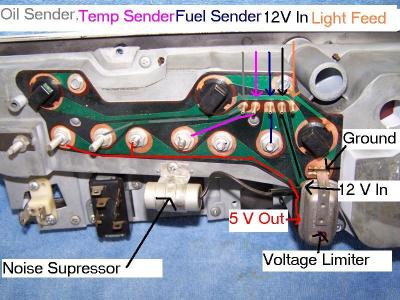

It might be the gauge. I would start looking at the wiring to the gauge first by tracing the wire up to the firewall plug and then up to the dash.
I never messed with the 70 "rallye" dash, so I'm shooting a little bit in the dark here, but does anyone know if that has a printed circuit board on the back like a 69?? If so, that is a possible culprit.

No, the board is just a convenient way of wiring the lamps and gauges. No real "electronics". I don't know if a 70 has this board or not.
The runs on the board tend to have some issues over the years. The reason I mention this is you've mentioned a problem with your clock too.

See those pins? There's a plug that goes on them. I'd reach up behind the dash and make sure that's pushed all the way on.
