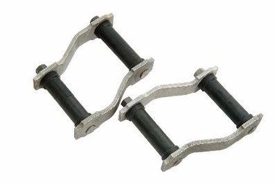

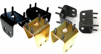

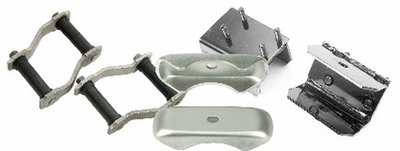

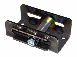

98snakeater the car looks like it launches pretty good now, in that video anyway... as you probably already know, you can fit quite a bit of tire under these RR's, especially with the right rim & offset spacing... usually will rub up at the top of outer side of the inner wheel well, where it tappers in with a tall/wide tire, I know a few guys who've done the bottle jack trick inside the wheel wells to alleviate a few of the minor rubbing issues up there... can always trim the lip a little {or roll it under too} offset spring hangers if it's rubbing on the inside by the springs, or add a thin spacer if you have enough room still on the outside edge.... maybe make or buy a custom front spring mount & shim the housing for proper pinion angles or add longer rear shackles, just don't use the cheesy 70's style good luck the car looks & sounds great...
