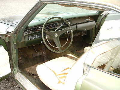

The first thing I noticed after buying my RR was that it was a bucket seat car which appears odd to me since it has a column shift and no signs of a console mounting on the floor, were some of the cars sold that way, course its odd that it has factory air and no power steering to me also. I was just wondering if there were members here that have column shift, bucket seat cars.

Yall have some good insight into this, There is steel reinforced mounts on the floor for the buckets, there is no mounts on the hump for a console, it would be true the seats probably weigh quite a bit less than the bench, seats match the interior, along with the belts. Previous owners are Dead, No One to ask LOL

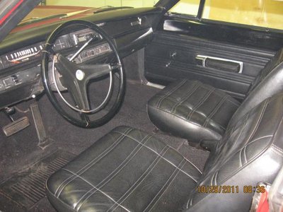

Here's my bucket seat column shift 69 Road Runner. About 99% sure it's all original, and I'm keeping it that way.
Your emergency brake release lever looks almost as bad as mine. Almost. :basketcase:
