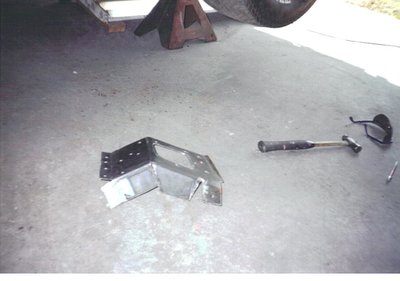

Still need some torque boxes for the front end. Waiting to order to see if I need the rear pair too before I place an order. A couple guys are selling the boxes on ebay. Anyone using a set they'd prefer? AMD doesn't make them.
I'm sure the list will grow as they start to break down the rear-end of the car. Probably need a new rear leaf spring mount set, and possible frame rails too. I'll order that and new bumper brackets for the front and rear next month when the wallet refills a little.

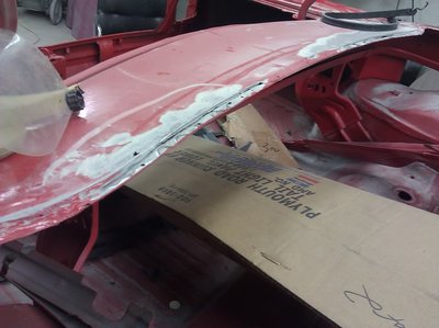

Also, I really need a deck filler panel (see pic below). No one makes a repop for a convertible that I know of. Anyone know of someone with a vert they're parting out that has a good filler panel? I have a friend of a friend that is driving right now to Desert Valley in Arizona. He's going to lookout for one. My fingers are crossed...

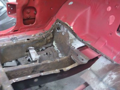

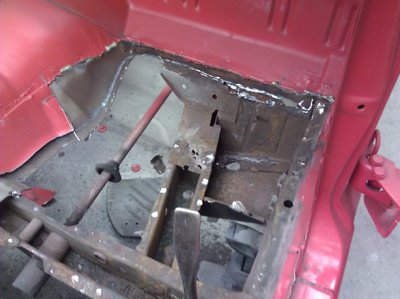

Took some pics today. I still can't believe what a shitty job that first guy did. There is a lot of bare metal that is all rusty already that he just left bare. The hack even double stacked the floorpans!! What's worse, he just left them bare metal when he put the new ones over the old.
Why prime or paint the other side of the lower grill panel? Such a hack this guy was!!!

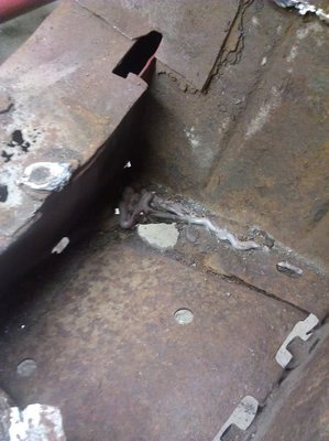

This is the kind of stuff he covered up without fixing...
Toasted out torque box on front passenger side...

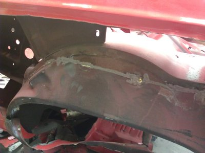

Drivers side outer wheelhouse. I'll be buying those...again.
Deck filler panel packed full of fiberglass...just like the rest of the car.

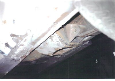

Caulk in the torque box?!?!? Seriously? He "patched" the frame rails with that caulk too. :brickwall:
