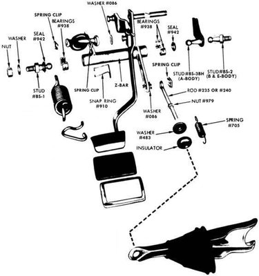

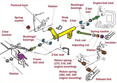

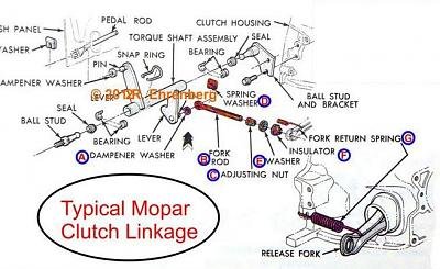

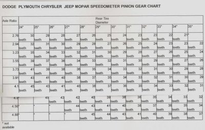

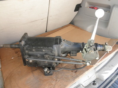

here's a exploded view of the parts underneath, the peddles etc.
