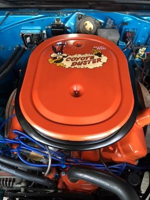

Anybody successfully get one of these stickers on a 6 pack air cleaner lid? I destroyed one last night trying to get it on there. I admit that I tried it dry and that was clearly a mistake. Is dish liquid the best way to do this? The angle on the lid where the decal goes is the problem and even wet, I'm having a hard time wrapping my head around how this thing is going to go on there right.

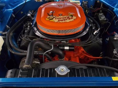

They don't lay down perfect I did get mine down fairly well using windex

I just used water and had my wife help out to hold in right place went on well.

They don't lay down perfect I did get mine down fairly well using water
Yours looks good, my problem is that I'm wanting it on a six pack lid and the depressions are closer to the ends than on the Hemi lid. The 6bbl lid doesn't have enough flat surface for it. Even though it isn't original, I want it on there so I may end up triming off as much of the lower clear part of the decal as I can and slice the bottom in a few places to compensate for the angle.

There is the problem. 6bbl didn't use the decal, just the 383 and hemi with the air grabbler

That's right. I destroyed the first one attempting to get it on the bottom and it just flat won't fit on a 6 bbl lid. Ma Mopar never put this decal on the 6 bbl, just the hemi. If I had an A12 car, I wouldn't have anything on there but I don't and the Coyote Duster is just way too cool not to put it on there!
