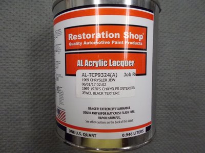

Can you post pics or part numbers of the products you have used? They turned out great. I would guess that the product you used can be tinted. My RR seems to be the same medium blue as the upper door shell above the door panel.

The dash is the only part that gets the suede finish the doors are painted with exterior paint. Here is what I used, Its from TCP Global in California the restoration dept. Kind of funny it is illegal to use in CA. but they mix it and ship it.DSCN0745 (1024x768).jpg
I looked at your paint source for green paint for my dash. Came up empty. Jokes aside, do they have other options besides black?
Did you call them and ask for the resto shop?
Now there's a thought. I just looked around the website. When I get closer I'll give them a call.
