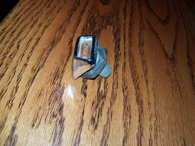

Hey folks , did any of these come on vehicles prior to 1968 and also is the pigtail/lamp socket available anywhere?
7,705
Dan I got lucky mine worked. It did not look all that good so just cleaned it up the best I could. Good luck buddy. Josh mopart's might have them. Got my stainless steel tip's a little cheaper than classic and others.

My 69 will be converted over to 4 speed, the lamp assembly I have, the bulb socket and wiring I dont
7,705
When I took mine apart to clean it. The wire is solider to the bulb its self. No socket. Ground to the big nut That hold's it to the dash. Don't think they wanted us to replace the bulb with buying the hole part.
