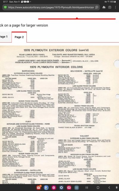

I know you said that its not a concourse restoration, but wanted to give you the option to use the correct paint for the dash bezel.
The color is Jewel Black 9324. They call it a suede finish. Any auto paint store should be able to mix up a can for you.
