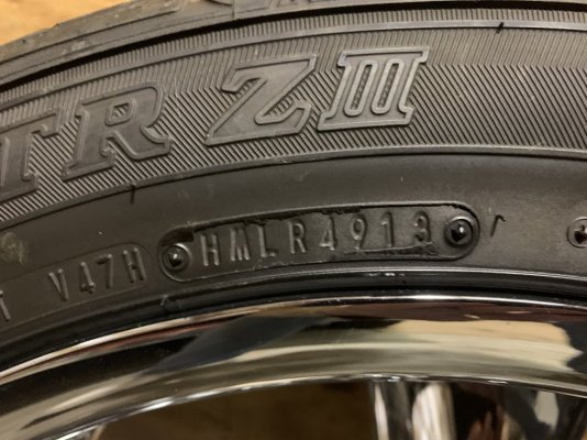

There is a 4 digit number just after the DOT. The first 2 are the week and the last 2 are the year. Example shown here was made the 49th week of 2013
