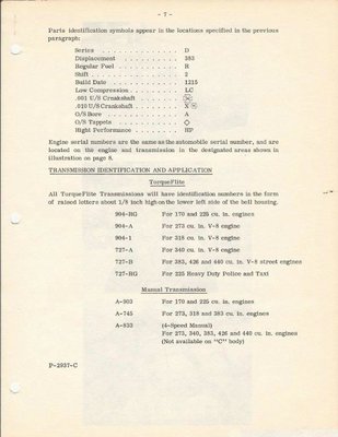

also to the topic of strange codes .............on my engine block pad,bottom line
says BORE 030 . Now I havent seen that in my research but a buudy says that occassionally a line worker in the doundry would bore one out because he was a "race guy" Does that make any sense?
I've had .020 oversize blocks before. Really what it is a factory screw up. The block was bored/honed too large for the pistons and the block was saved from being scrapped. They also did oversize lifter bores with some blocks.
From our Reference Section, TSB 69-25-01
