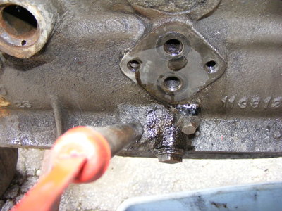

In the first pic, you are looking up at the driver's side of the engine. The black thing in the top of the pic is the starter. Its missing one bolt at the top and the brace that goes from the block to the bellhousing.

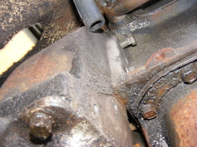

Second pic is the passenger side from the bottom up. This time there's a bolt in the top hole, but its sticking out. No brace on this side either.
OK, there's two bolts on the side... what about the top of the bellhousing? I couldn't get a pic... but the two bolts at the top of the bellhousing are missing too!! There is only two bolts holding the engine to the bellhousing!!! WTF????

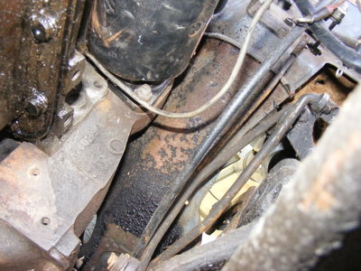

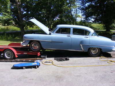

The third pic shows my "Poor man's lift".

That's a fun looking project,and I never thought of using the trailer like that :thumbsup:
That's a throwback to my racing days. Guys used to do that all the time in the pits to work under their car. I've seen more then one transmission changed in the pits that way.

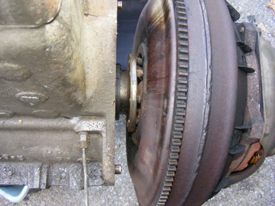

Pulled the engine and trans today. Found this:
No nuts on the studs! The fluid drive wasn't fastened to the crank!!
And I actually had this engine running!

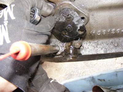

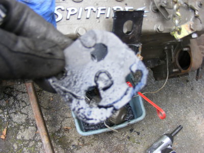

Also found why I didn't have oil pressure. This gasket was cut by hand by some "mechanic" for the oil filter housing. First mistake... well... it doesn't use a gasket, it uses a couple of O rings. Second mistake... It wasn't on right and it blocked the oil passages.
