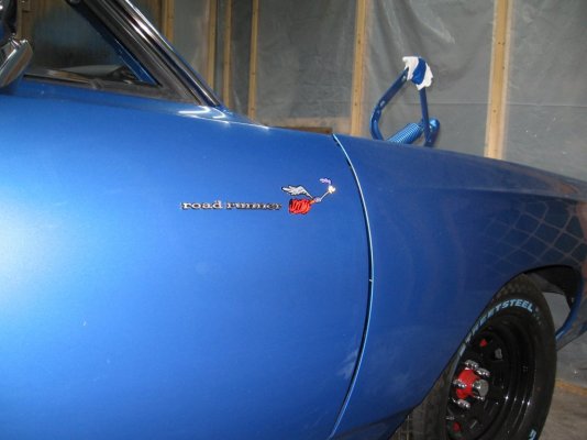

Thanks. Working on getting it out for the first drive on the 10 of June for my birth day. That will be the best present of all after all the year's of working on the car. Want to get a photo shoot of it out in a park some where. :thumbsup:

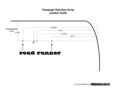

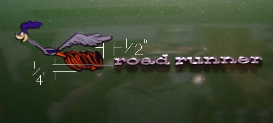

And here are the measurements for the running bird decal in retrospect of the road runner emblems.
