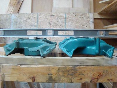

Well I picked it up today and just needs cleaned up and a coat of paint. Here I. The next couple days it will get a trip to the media blaster.
