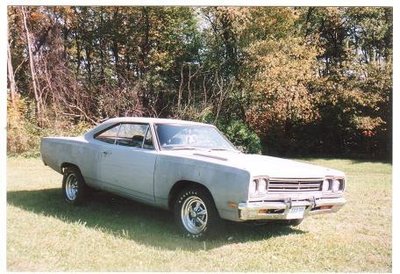

don't be stingey....feed the site pic whores! looks pretty good Drew. This was my last one. got it this far before I lost it.
what are your plans for yours?

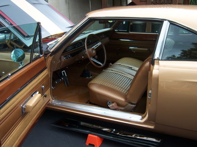

Hi, H2T is the saddle interior, T7 is the door panel paint code (Saddle Bronze) Here's a pic of my T3, H2T, T7. Love those colors.. I am kinda' of bias on those colors though. :lol:
