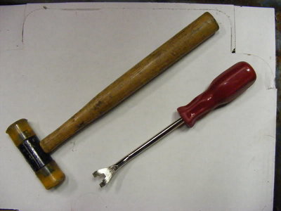

First, you'll need a hammer (I prefer a plastic face Stanley) and a door panel trim remover.

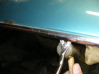

You put the tip of the remover up against the bottom edge of the molding.
And smack it with the hammer.

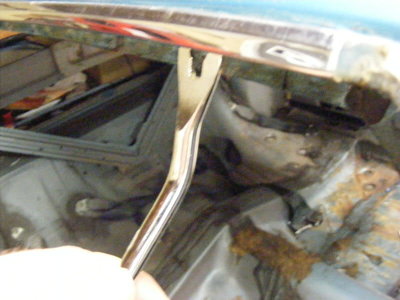

With a little patience, you work your way along the molding, hitting the remover about every inch or so. You may have to go over it a couple times to get it off, but if you take your time and do it right, the molding is off the car in short order. The first side took me about 30 minutes and the second was done in less then 10.
BTW, I took the second pic by myself, holding the camera in my mouth and pushing the timer button..

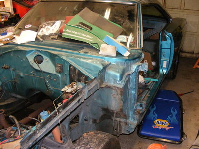

Yea.. I should have read the windshield chapter too...
I got really serious with the car. We've painted it twice since I've owned it, once about 1981 and once in 1992. It really needed to go down to bare metal and since the bottoms of the quarters had been patched way back when, they really needed to be addressed. With the new AMD quarter panels looking better then the NOS and used junk (if you can find them) I decided to go all the way with it.
I need to take some new pics, but right now, its about 2-3 hours of work away from being up on the rotisserie.
