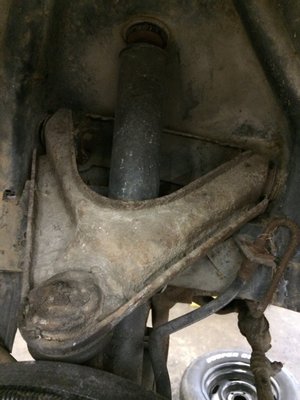

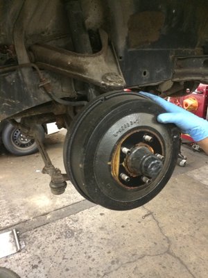

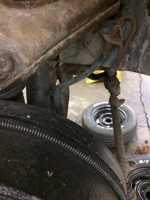

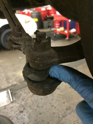

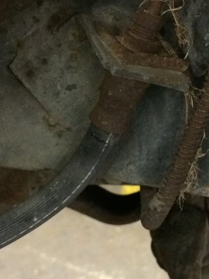

Hello Roadrunner geniuses...
I'm going to rebuild the rear drums first but since I'm doing that, I know I need to replace a ton more and I want to do it while I have the breaks off:
Recommended rebuild kit for drums?
Recommended control arms, do I need them even (are MOPAR okay)?
What else should I do well I'm in there?
Pretty sure I need everything...but I don't even know what that is!!

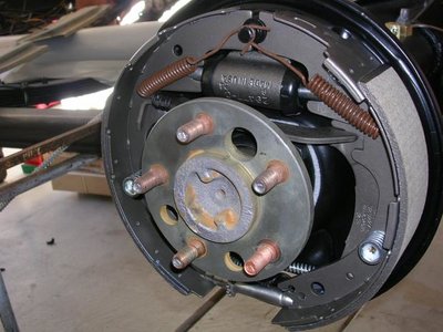

Brakes are a great place to start. Take pictures of setup before you start so you can put it back together easier, will want to clean and paint things like backing plates, should rebuild wheel cylinders, change all bushings and such things as tie rod ends etc, also all soft brake lines and very carefully inspect all steel lines for rot and rust.
Personally would consider switching to disc setup, but that is up to you. :cents:
Thanks quikbird...I'll be switching to Disc up front but I can't afford the back right now and just want to make this baby a tad safer to drive until I upgrade the front to Disc :)
Anybody on here done what I plan on doing i.e. rebuild drum with new parts and rebuild everything else minor while in there? Pics would be greatly helpful!

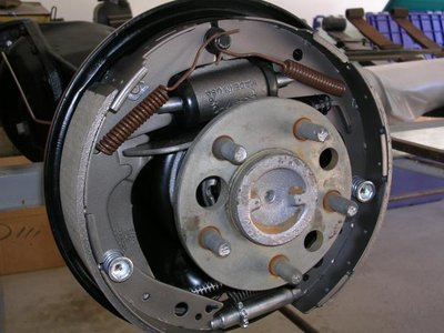

NAPA has everything you need. Rock auto might also. Pictures? I have pictures :D

Go ahead and get some new flex lines too.
Check the leaf spring bushings. If they are the same age as the rest they might not be there at all.
