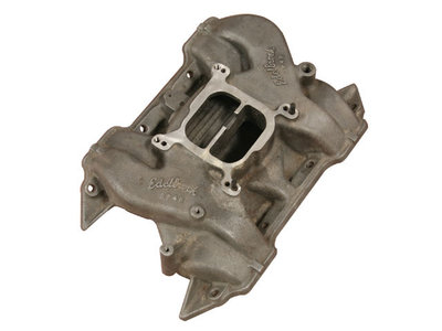

the B-block (361-400) Performer's looks almost exactly like a DP4B (with EGR and choke mounts) in reverse.

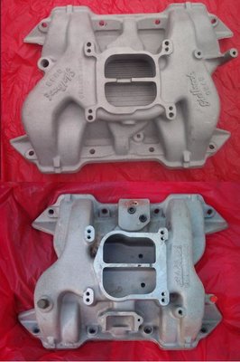

First is a pic of a Stock 67-69 4bbl vs Edelbrock Performer. You can see similar runner sizes between the two, but the performers seems to have a more flow friendly layout.

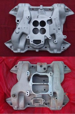

Next up is the stock intake vs a CH4B. The CH4B has what appear to larger runners and sweeping runner design vs the stock piece. The CH4B also loses the stock choke mount.
finally let us look at the Performer vs CH4B. The CH4B appears to have larger runners and a slightly more swept and less angular runner layout but loses the stock choke mount and EGR mount. The Performer also will accept at spreadbore carb without modification but the CH4B does have enough meat to allow it to be "hogged out" to accept one as well if so desired.

In the top pic you will notice that the runner layout is reversed. Cylinder #1 on the DP-4B is fed from the lower bank while the #1 cylinder on the Performer is fed from the upper bank.
That was what I was trying to say in the original post. The runners look almost identical but reversed. If you turned the one or the other around the runners would be nearly identical.
