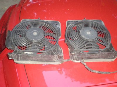

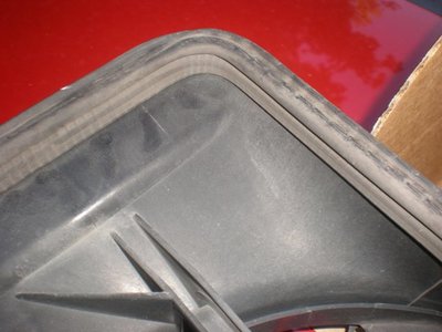

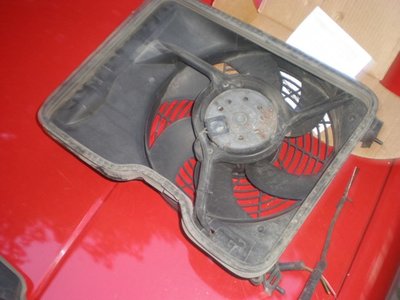

I run a dual fan out of a caddy catera 98 , they are pushers so i can run the standard fan then. I have these on a toggle switch so i can turn them on when hot out or in traffic . These caddy fans are cheap in u pick it yards and are super heavy duty .... They come with there own shroud and push a hell of alot of air . They also have a nice big rubber seal to seal up air tight to my condenser .
