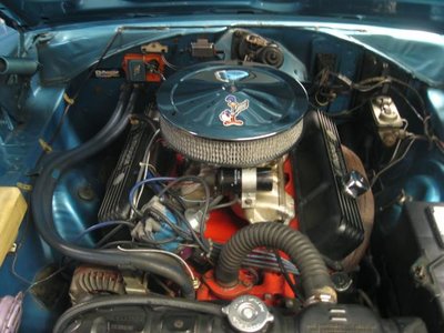

If this is what you are using (firewall, left side), you still need the ballast.
