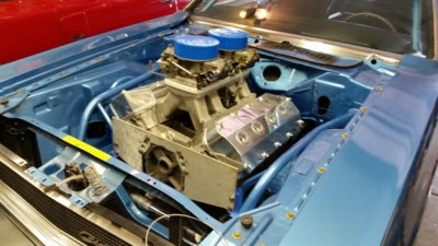

Same here with the help of a painter buddy. I welded up all the holes, ground the welds, prepped everything and bought the materials. He brought his gun and sprayed the primer, sealer, color and clear.

Ties into the roll cage at the A pillar bars inside and also mounts to my front and mid plates to the chassis. Here is a better shot mocked up.
7,813
3,393
Yes with that bad boy motor need extra support not to tweak the frame and body. Good job. Hope you get a lot of fun out of the car. Good job. :steering:

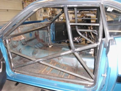

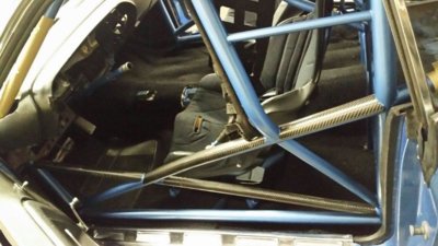

Thanks. Here you can see the engine bay snout bars tieing into the cage before dash was put back in. And the finished and painted cage.
