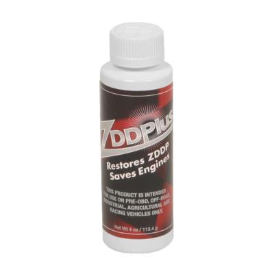

I really like the results on the Shell Rotella T5 10W-30. I have a 68 stock rebuilt 383Mag with about 10K miles on it. Would you add any additive to the Shell Rotella T5 10W-30?
I use Rotella T5 10W30 and add a bottle of ZDDP plus.
