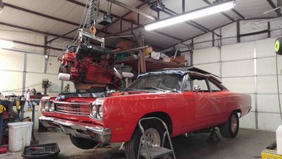

I have used all of these methods for removing/marking the hood hinge locations.
When we pulled the 440/833 out the 69 RR we used our over head hoist.69RR15.jpg
