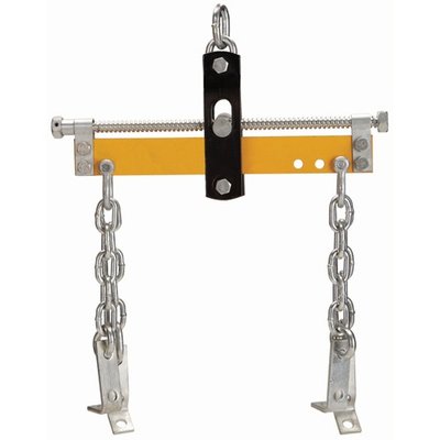

i did mine with tranny and all......do you have a engine equalizer.......this makes it easy to tip the motor when you get it in there......yes i did jack up the car for clearance of the tranny

next dumb question where do you guys normally bolt that to on the motor? I usually go across diagonally from the lt front cyl head to the rt rear with a chain bolted using 3/8 bolts. This equalizer thing looks like it should be bolted in along the centerline of the motor. I don't have one of those mounts where you can lift off the carb mounting as that always look kind of freaky to me, or is that what I should be doing?
I for sure am going to get an equalizer today and I had never even heard of one until now - Thanks
724
Mine has 4 mounting chains. I put one on each coroner of the intake bolts. Never had an issue.

Yep, those equalizers are the real deal. I installed a 289/C4 in the 67 Mustang I did for my wife, by myself, in less than an hour. Can't wait to used it again on my 68 383HP/4SP RR!! Figure I might have to remove the radiator support first, but no big deal. :beep: :beep: :beep:

if only the radiator support bolted in that would be very nice way to go. Anyways engine and trans are in and bolted up, thank heavens I'm glad that's over, thanks for the advice the equalizer worked super well.
