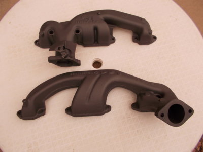

For a customers car I went to my local powder coat shop and they offered two shades of high temp coatings that take more heat than jet coat. I used Jet coat on mine no complaints but they closed shop in Phoenix. Oh his idea to do the heat riser with it
7,832
3,408
Those look good 69hemi. Yes Rain Man they are improving on the spray can product's. I must have gotten the cheap stuff.

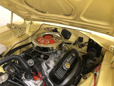

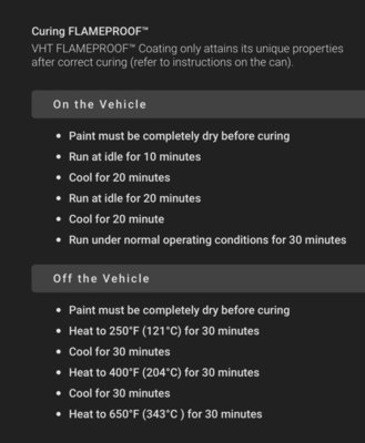

But cast iron looks great. Follow the curing instructions or failure is likely. I’m expecting failure on mine eventually as I didn’t heat cure them due to impatience and the fact that my wife wasn’t keen on me putting exhaust manifolds in the oven. If I have to redo them eventually I will...
not the best shot of the manifold but does show the General finish somewhat
