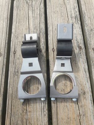

Exhaust tip hanger on 68-70 RR

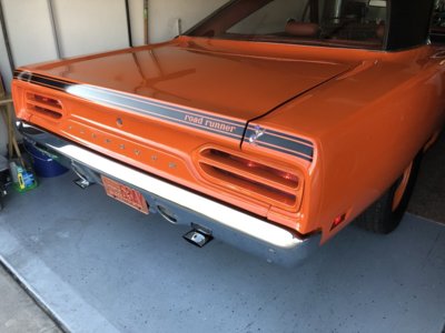

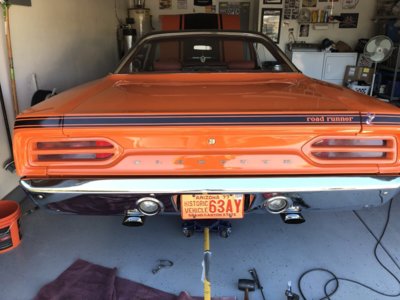

I like it. Are you concerned with the tip not having a clam on it. Just asking. Think with the hanger it will be secure. Know you don't want to scratch the chrome. Russ.

Dumb ass year one sent only 1 for $50
I have to call and either get a second 1 shipped or if it’s 1 for $50 return it and buy straight from dales cuda shop for $52 for a pair . Yearones wording said “hangers” so I thought it was for a pair, have to call the basturds today to find out. But yes pretty secure would like to get tack welded tho. And put on hangers on. Good eye Russ!

No don't weld near the chrome unless you use a welding blanket and wet it down. Don't want to ruin the chrome or blue it. Yes and year one is really high on their shipping. Just like classic. The sipping is higher than the part sometimes. That is what kill's me. I ordered the frame bumper stops for the rear axel not to hit the frame. Instead of them being pyramid shaped they where rounded at top. Said for 67- 70. The don't come with mounting bracket. But these did so put them on. Can always change them at some latter date. After seeing all you have done to the car in the past month's thinking you can take the for sale sign off of it and just enjoy your labor for a while. I think how many people you know have a Runner after all. :thumbsup2::thumbsup2::thumbsup2::thumbsup2: :lol:

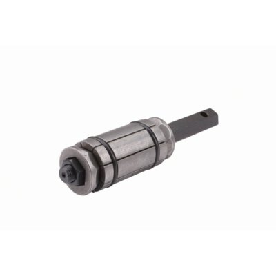

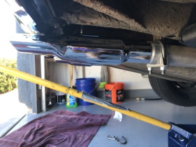

967B381A-CC1C-48FC-ABA7-63DCBBA4456D.jpeg Looks clean, so was able to fit new ends into existing tubing? A pipe expander can enlarge a pipe enough for one into the other. I’ve found on cars connections don’t seem to be in right order. Meaning not as a stove pipe install; as next pipe always goes outside over preceding.

Used adapter,
Actually the tips on a 70 B body went into the pipe

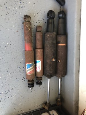

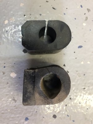

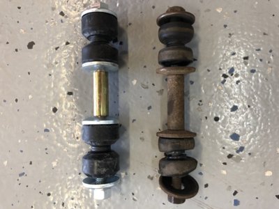

I did the shocks and sway bar bushings and end links , drives good

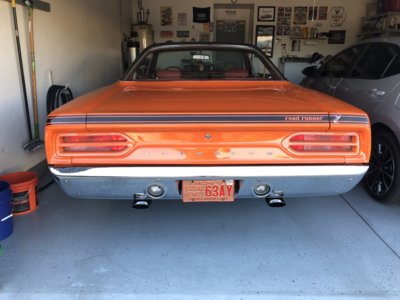

I'm putting a TTI system on the RR and trying to figure out how far the tips are supposed to stick out.
It's different from the factory. The bracket is on the pipe and I've got to cut the pipe back to install the stainless oval tips.
But is still uses a hanger like in post 2.
