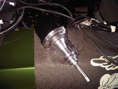

Dual sync dist with cam and crank sensor for sequential injection.

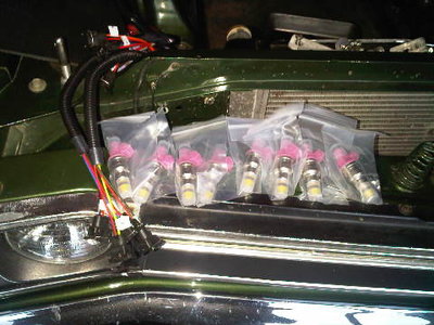

Injectors and harness.

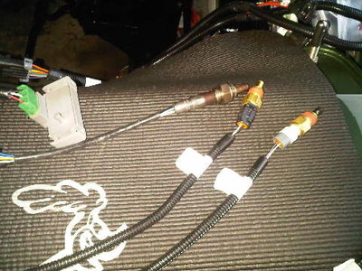

The close up of Map , H2O , water temp. and AFR sensor
[attachment=1:2gg8k36q]F&B EFI Sensors.jpg[/attachment:2gg8k36q]

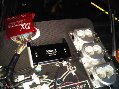

TB's (660cfm each) with dual fuel pumps and XFI ECU.
[attachment=0:2gg8k36q]F&B EFI TBI XFI.jpg[/attachment:2gg8k36q]

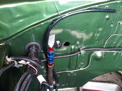

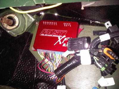

[attachment=2:mybrdyth]Efi firewall.jpg[/attachment:mybrdyth]
Nice hole through firewall with fuelline and return line in place.

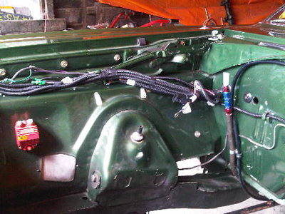

[attachment=1:mybrdyth]EFI harnes.jpg[/attachment:mybrdyth]
Plugs for : TPS,AIC,H2O,O2,AFR,etc.
[attachment=0:mybrdyth]Xfi placed.jpg[/attachment:mybrdyth]
Wasn't using the heater anyway(528Heater worked fine) , so made mounting board for XFI and MSD in it's place.
Still need to make the wiring route nice.

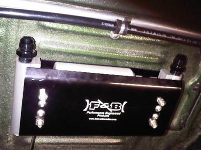

Placed EFI Fuelpump. Not easy to find good spot under car wich is away from exhaust.
[attachment=1:2a1pmb4f]IMG00408-20121006-1104.jpg[/attachment:2a1pmb4f]

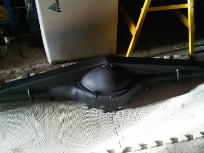

Braced 8 3/4 axle . Hope it survives the Hemi.
[attachment=0:2a1pmb4f]IMG00409-20121006-1712.jpg[/attachment:2a1pmb4f]

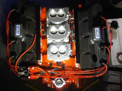

Picked-up the new engine bay filler yesterday.
Started fitting Fuelrail , TB's and linkage this morning.

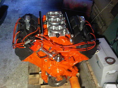

[attachment=1:6hk81t7l]Hefi installed.jpg[/attachment:6hk81t7l]
Here's the peanutside of the elephant.
[attachment=0:6hk81t7l]Hefi colse-up.jpg[/attachment:6hk81t7l]
Have to do some smoothing in the crank for the convertersnout to fit propperly.
Think it's in by Thuesday
