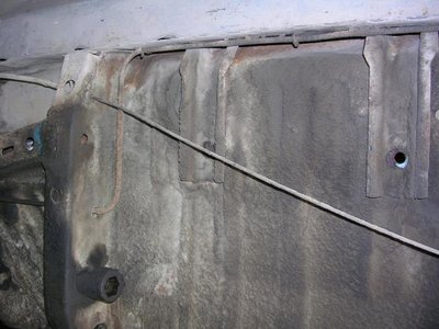

Undercoat was black the same as in the wheel wells. If you are after the original look Resto Rick has a good product, it is a bit pricey.

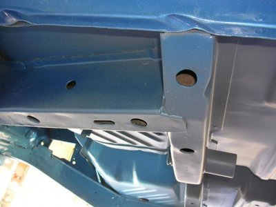

There was primer color towards the center of the floorpan and body color on the rest for cars that weren't undercoated underneath, but never silver undercoating.
I'm with John, they had a gray dip primer and body over spray similar to my picture. If you got factory or dealer undercoat it is black rubberized tar as in my second picture. Are you asking about under coat or the color of a non under coated car.

I have to go with Big John on this as my Runner has the under coating on it from side to side and front to back.
The only place the grey primer is seen on my car was when I replaced the gas tank and it was like it was just painted.
