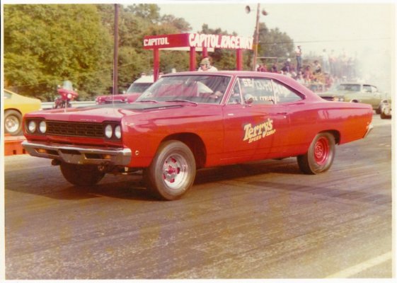

97when I started racing back in 1970 my 68 with 383 bird ran with street tires pure stock 14.43 @ 96 mph as I changed a few things went to 7 inch slicks 4.30 rear headers and a reworked avs carb a hurst supershifter finally got it down to run 12.97 to 13.20 depending on heat and track conditions shifted at 5400 rpm max went through the traps at 5400 rpm in high gear and that is pretty much the limit for a 383. Now if you want to go faster then you have to get more serious and get in to the motor, cam heads etc.but I tell you this the only thing I ever broke was push rod through the rocker arm and freeze plug rears is another story. BUT THAT STOCK 383 WAS ONE TOUGH MOTOR IT CAN TAKE A LICKEN AND KEPT ON TICKEN FOR 9 STRAIGHT YEARS OF RACING ALMOST EVER WEEKEND!!!!!!!!!!!!!!!!!!!:thumbsup2::beep:
