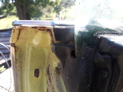

Is their these felt plugs at the end of the cat whiskers on a 69 post car. See them for sale but did not know if I need them or not. If any one knows would appreciate the info. Russ.

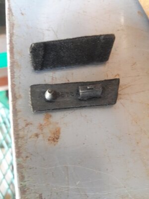

They were used on all of the 68 to 70 B-Body applications except for the convertibles and four door sedans. Depending upon the vendor, expect to spend about $16.00 per pair.

End of cat whiskers stop window from rattling. talked to the sales man at Stephens when ordering the window track that is what he told me.

They are primarily cosmetic to finish out the area in which the outer window felt does not cover. Many cars are missing them as the owners do not even know they were used, although there would be the extra empty holes at the upper end of your door.

Yes I was wondering why that their was a gap at the end of the cat whiskers. That is what happens when you buy a car that is missing a lot. Thanks again. Russ.

Yes Big Mo. That is something a lot of people miss it seems. I did not know all the car's get them. At the end of your cat whisker's on the out side. I noticed that it did not make the full run to the end of the door. Part's mix has them. But got mine coming with the window channel I was missing. :thumbsup2:
