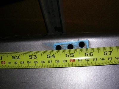

Does anyone have a template for these? Im adding these to my car, and I don't know where the holes were drilled from the factory. Also, what size hole need to be drilled?

Thats up to you. If it's easy for you to do, that'd be great. At least that might get me in the ball park.
Thanks!

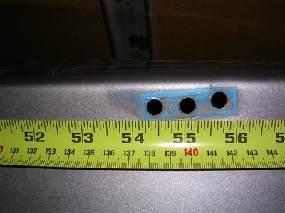

No problem I have a fender that had one on it from the factory.
22,148
2,358
I had to run the tape from the outside edge of the fender on the door end of the fender. It was the only good edge to start from the front is to rounded. The holes are crooked for a reason so don't straighten them
