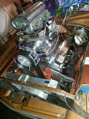

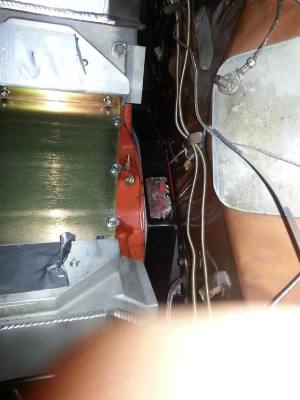

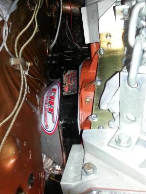

I got the new trans in today after getting the converter yesterday,Thank goodness for the engine tilter!
This is with the trans all the way back in place with the flexplate shield on.
