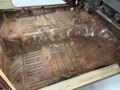

sorry if this sounds silly but chargers have a brace on the inner seat bolt holes, but as my road runner was a bench seat , now has buckets, do road runners have these braces , are all b_bodys floor pans the same ,, 'thank you

They do sell the outer braces separate. When ordering the floor pan got it for bucket's so they came on the pan I got. Good luck doing a good job. :thumbsup2:
